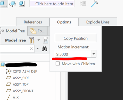

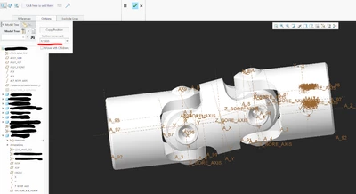

I have a struggle with an exploded assembly, more specific the rotating portion in the exploded view.
When I go into explode on the assembly and instead giving a distance I give an angle and
select the rotating axis and the components I want to rotate around the selected axis,

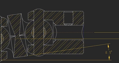

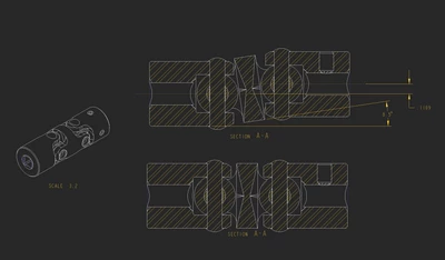

it does so…but…the specified angle in my case 9.5 Deg shows up on the drawing as 8.5 Deg
Anybody else has had this issue? Anybody has a fix for this?

Did you happen to move it in the negative direction?  One direction the angle value will go up by your increment (9.5).  The other direction, it will give you a value somewhere below 360 based on multiples of your increment (9.5).  Given your increment of 9.5, the first multiple below 360 is 351.5.  That is 8.5 degrees from your start.  Watch the number in the tool bar.

Thank you for your reply, and thank you for solving my issue.
I would have never guessed that the positive or negative angle call out would make a difference,
Since you have the choice with the direction arrow to choose in which direction you would like
To rotate your parts in the exploded view.
