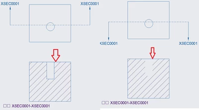

if I do "flip material removal side" after make section and arrows
YK_TRIONNET_KR
I am using Creo Parametric Release N/A and DatecodeN/A
the lines are gone..
... additional note.
Edit view definition set Hidden line display instead of No hidden.

this is because the x-section plane is hidden behind the material.
Martin Hanák
You don't indicate what version of Creo you are using, but judging from the behavior it is probably an older one. This kind of thing would happen all the time if I switched the material side. The only surefire way I found to fix it was to turn off or remove the section activation in the view, then re-activate it.
