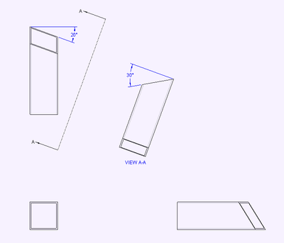

I  am having trouble creating properly dimensioned drawings of compound miter cuts on HSS square tubes. The annotations are difficult for the shop to interpret. ( see picture attached) So the next best thing is a pipe wrap template that the shop can use to mark the tube for cutting.

Here is a little inspiration on how I would detail a compound miter:

This is basically how I have been doing it. The difficulty is when the tube orientation relative to the cuts is not on a surface but at an angle and there are more than one compound miter per end and there are other miters on the other end. Keeping track of XY, XZ, YZ etc planes is a challenge and bogs down the productivity. Sadly we have no standard, several engineers using several different CAD systems as we are all freelance designers working autonomously on a common project with multiple builds going on so fitting my job into the shop flow is best done with clear and obvious prints. The closest thing to consistency is sending the flat patterns DXF's to our laser guy to cut wrap templates. How we get to that point is a up to each persons preference and system capabilities. I think avoiding such joints may be a worthwhile effort.

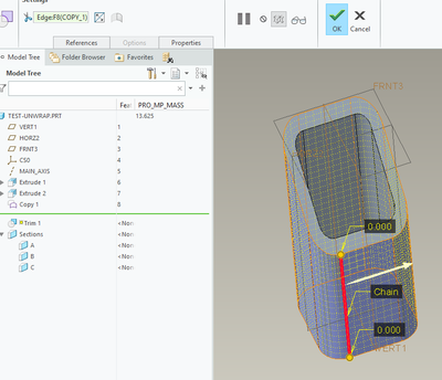

@anthonyws
I selected the external surfaces.
Copy/paste to get a surface feature I could work with.

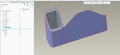

Then I used the trim command to "trim", See the second image for the tangent line I picked.
Then went to surfaces - flatten and picked an origin (I used a vertex)
people with more surfacing experience may have a much better process! I'm a hack, get the job done and move on!

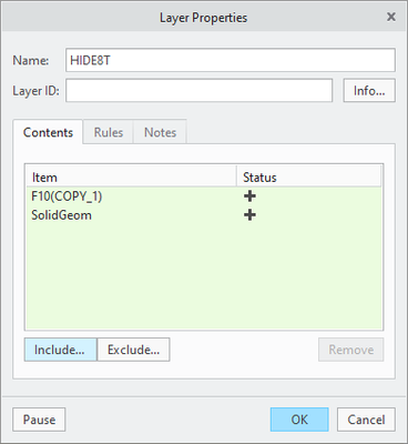

That's right. copy/paste. ok, that works to create the surface and I can flatten. now I have to make a dxf of this "flattened" surface. I can't figure out how to hide the tube part or copy paste the flat surface to a drawing for export to DXF.

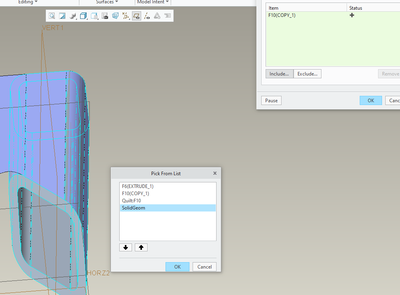

To show just the flat surface, make a layer, add the tube as "solid geometry" using query select to get that to show up, I honestly have no idea how to get there except using query select (pick from list on RMB)
To show the tube in the design, make a layer for the surfaces and add the surface features to the layer and blank it.
On the drawing, you'll have to manage layers by view.

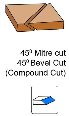

Does your organization have a standard for how to document compound miter cuts? If so, are you not able to document this in Creo? If not, you should establish one now and get agreement with the fabricators. How are they making the cut on the shop floor? Is it with a miter saw?
With only two angles (bevel & miter) one can define the cut orientation relative to the workpiece and then specify a location on the tube to make the cut.
