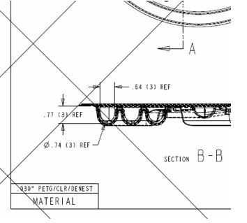

We are using Creo Elements/Pro, Release: 5.0, Date Code: M110 and we have a sporadic problem with pdf output of drawings. Several of us in our group have come across some drawings that output the pdf with diagonal lines across the whole sheet. They are not there on the drawing, but export to pdf. The problem is very random and we are unable to find anything common to the drawings it happens to.
Our workaround has been to print to an Adobe pdf printer and then open with Adobe Acrobat Pro and run an OCR to convert the text so we have searchable text in the pdf. Kind of a pain to have to do that.
Anybody else having issues with this? Have you found any solutions?
Her is a partial screenshot of the incorrect output.

Try setting config.pro option intf_pdf_use_adaptive_linestyle to no

Sorry it took me a while to reply. Been very busy lately. I tried most of Brian's ideas and it seems like an issue with the Creo/ProE output of the PDF. If I print to Adobe PDF printer or use CutePDF printer types the output is correct. If I print to .ps and convert to PDF it is also correct. If I do a File, Save a Copy to PDF or Publish to PDF from the Creo/ProE toolbar, I get these weird lines going thru the whole sheet, no matter what settings I change for the PDF output. We use 300 dpi, but I tried several other settings with the same results.

Okay, I may have found something similar to the drawings that the mysterious lines are showing up on the published pdf's. The 2 drawings I have right now that this is happening to both have drawing views with hidden lines shown. For giggles, I changed the views to No-Hidden and then they published correctly to pdf.

Wow! That worked. This must be a new config.pro setting because Pro/E didn't even recognize that in the search. How did you figure that out?

I was looking for a solution to a problem happening in CREO 1.0 PDF printing related to the pattern control in PEN 3 (which this option also solved me) and come across with this solution (This same problem had already happened to me also).
https://www.ptc.com/appserver/cs/view/solution.jsp?n=CS43973.
Glad it helped.
I am using Creo Elements/Pro 5.0 M120, and i can't find intf_pdf_use_adaptive_linestyle option in the config.pro. Any suggestion?
It is a hidden config.pro option, so you have to manually enter it with a value of no.
Wayne, you are right. I must enter it manually in config.pro by using notepad. Thanks.
