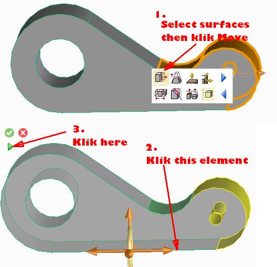

I am sitting here going through the quickstart projects to re-learn to operate Creo again.  I had loaded the latest version of Creo Elements/Direct Express version 6.  I have discovered that the qucikstart project "Create and modify a tangent model" does not work correctly when resizing the model at the end in version 6 but I had the older express version 4 on the machine and tried the same project.  It worked as the video shows.  I could not figure out how to get version 6 to produce the same result as video.  Maybe a bug of some sort.

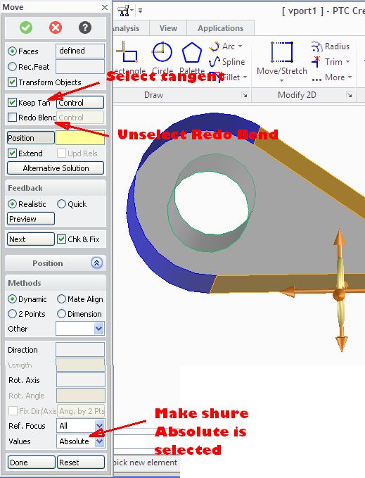

no not a bug but it seems that basic settings having been changed and now the Qwickstart is a litle out of date.
Follow the description in the pictures, then go on as previously described and it will work.
So do not press the spacebar but the green arrow to open the options menu and make the changes.
I guess that in the previous version "Redo Bend" was standard turned off.

I un-selected the redo blend just as your jpg showed and it worked exactly as the video shows now.  Thanks for the excellent answer.
Kirk
