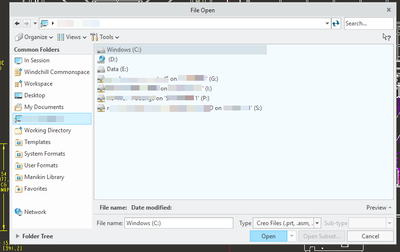

The easiest way is to share the location on the hosting computer and then map the drive so you don't have to go thru the network folder sturcture, which can take a long time if there is a lot of computers on the network. I also don't get anything when I click on NETWORK but most of our computers don't have shares and the ones that do are all "hidden shares" so they don't just show up.
Just as an example, I have 4 mapped drives... (names blurred to protect the innocent!)
