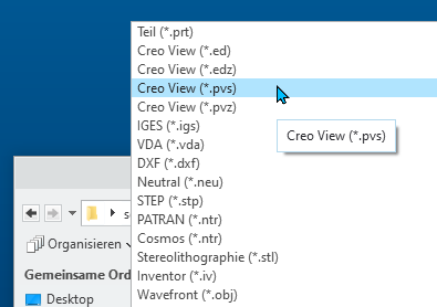

However, if you want to add your own custom arrow (or any other 3d symbol) you need to first export the 3d model to .pvz file type (I think it's only possible under Creo Parametric). Then unpack the .pvz archive and you'll find, among other, the .ol file. This is the one you need to add in the Creo Illustrate software as a new symbol geometry.
As TomM already said, you have to create the arrows in 3D with your CAD system. Then save as .pvz and unzip.
If you save as .pvs, you will get the .oi file directly.
You can then import the .oi file into the 3D symbol library in Creo Illustrate.

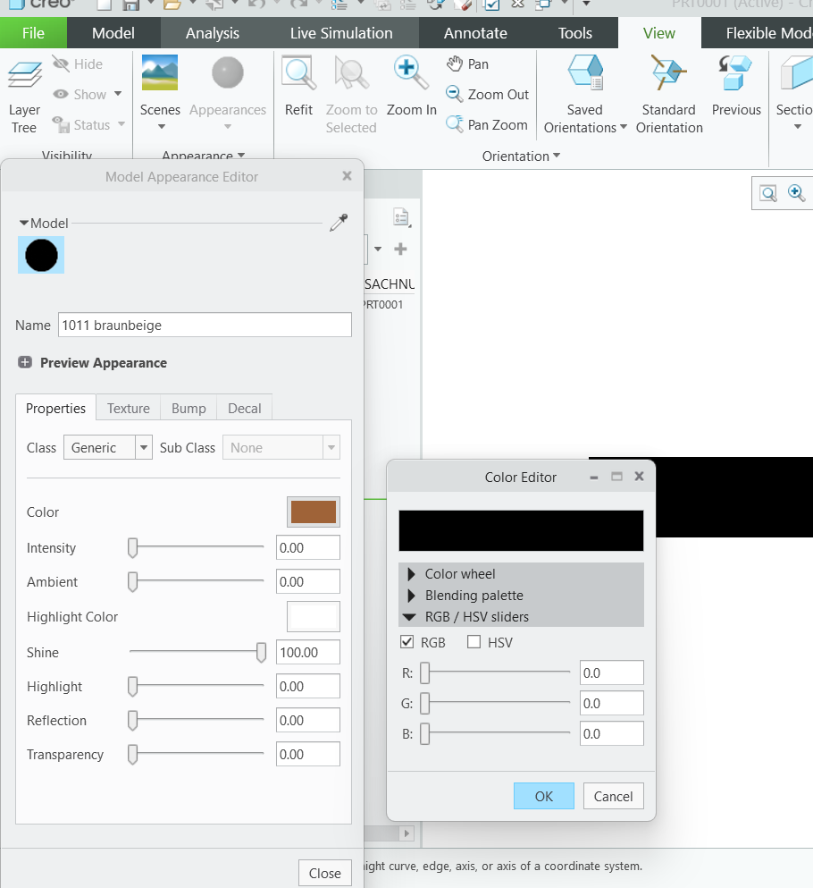

You can try do this if you want very black color
Hello ZX_10618597 (looks like a name from a different planet),
You can make the arrows as black as you like in Creo, but in Creo Illustrate they get a reflecxtion and are then not really black. Have you ever tried to get black 3D arrows in Creo Illustrate?
