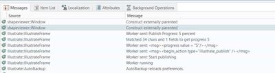

2. Some illustrations cause the worker to get stuck at either 5 or 33% of progress. Here's the messages window SS:

It appears there's a problem with a model and it breakes the worker. Removing the model fixes the issue.
What's weird is that removing a single illustration in which some items within the model are present in Item list fixes the issue as well.
