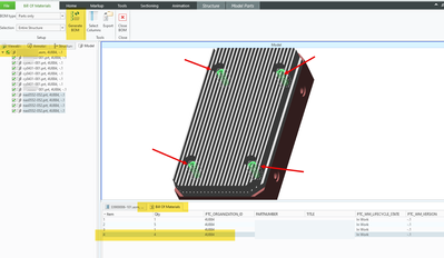

Go to Tools tab, select your top level assembly in the Model tab, then Generate BOM icon in the menu. Expand the lower data panel. You can select in the BOM on the bottom of the screen and highlight in the model.

I didn't have that option. Maybe a licensing issue. Seems silly to have to pay hundreds of dollars just to get a quantity
Using Find in Creo View lite(free), you can get quantity from the attributes table.
