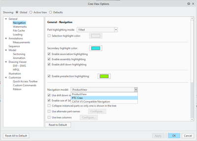

Best answer by romorrison
Hi David,
It sounds like you have the mouse navigation mode set to "ProductView" (which is the default) which has the middle mouse button set to Fly and the right mouse button set to Rotate.
I believe you may be looking for the "PTC Creo" mouse navigation mode which matches what's available from Creo Parametric.
You can find that setting in the options menu here:
Hope that helps!
March 26, 2020
Hi David,
Hope that helps!

Thanks romorrison, that worked perfectly.  My sanity is restored!
