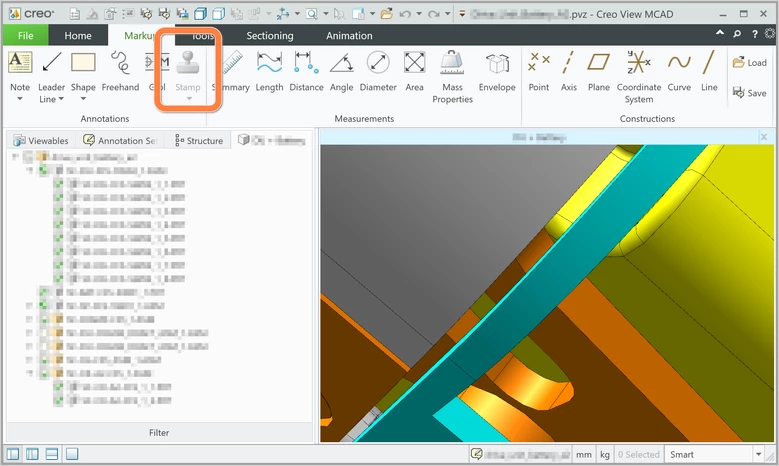

Hello Community,
Using Creo View, I'm trying to insert a stamp into a model, specifically into a PVZ file, but I'm having trouble.
The stamp tool button is always grayed out and can't seem to be enabled, see screenshot below. Can anyone tell me why this is happening and how I can fix it, so I can insert a stamp, as explained in the support article here:

Never mind, I figured it out.
It turned out that the reason was that no stamp had been created in the stamp catalog:
https://support.ptc.com/help/creo/view/r10.0/de/#page/creo_view/visualization/creo_view/To_Edit_the_Stamp_Gallery.html
