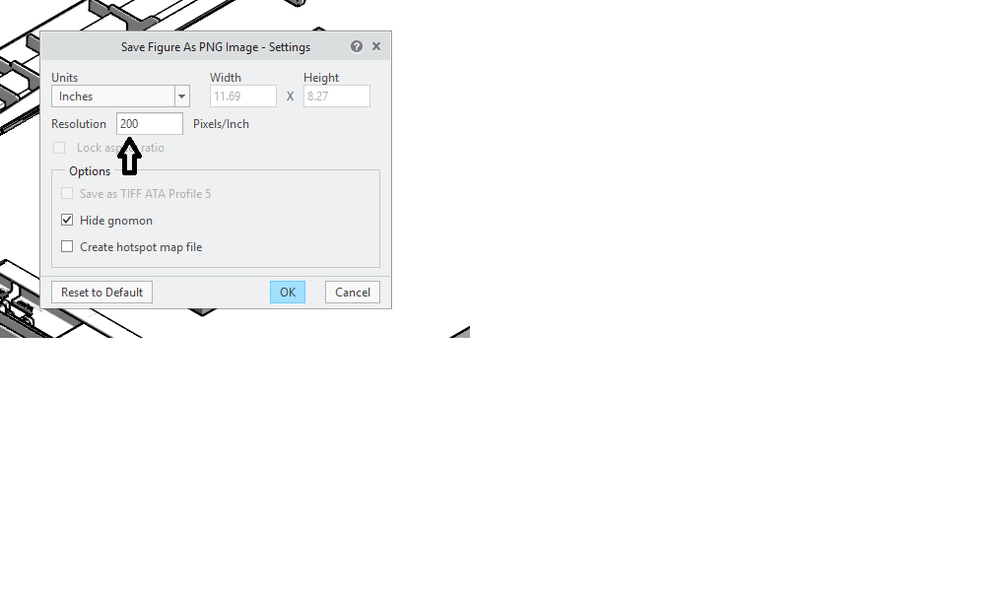

The issue is very frustrating, because the published pdf or svg doesnt look good.
The problem is about resolution and not about lines layout. The issue is also visible in figure viewing area when you zoom your model out.

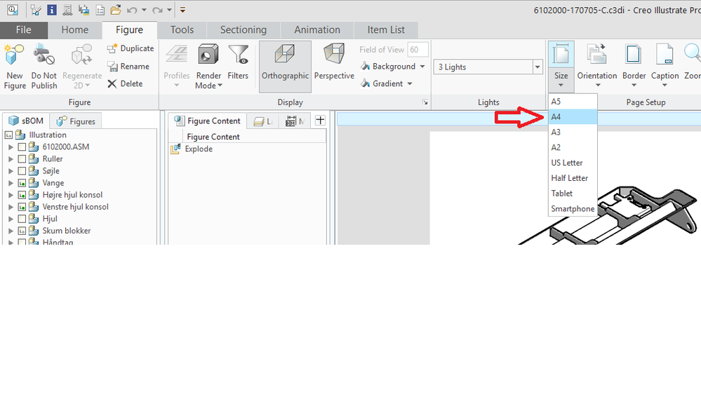

To resolve that you MUST choose a page size before you start working in the model. I always use A4.
Then you can adjust the resolution when exporting the figure, i use to use 200 pixels per inch, it gives me a sharp picture and not a big file.
Remember always to center the model in the page size.
See attatched picture
