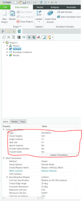

I am using Creo Parametric - Release 8.0 (connected) Release 8.0 and Datecode8.0.2.0
One of the engineers in this group is running CFD through Creo Flow, and the systems environment variables (CFD merge quality of 10 and CFD mesh control of 0.1) no not seem to be applied properly to the model.

Talk to my colleagues, there are some special things in your model. temporally solution is to export it to step and import it again. Then tessellate should pick up those settings. Or you can try creo 9. CFA tessellation in creo 9 expose all controls directly in the UI
PTC Support case was reported and using the Creo command Open System Window, we were able to confirm both variables had been set and read in the Creo session.  It was determined that the low fidelity of the geometry was related to the Edge Display Quality and Shade Quality settings which could be increased.

Hi Mike,
So does this means settings in Edge Display Quality and Shade Quality will affect the tessellation function in Creo Flow Analysis? This is even new to me. Could you explain this in details? thanks.
