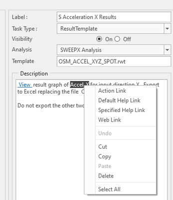

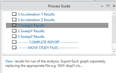

Finally templates are used in simulation process guides, where a hyperlink pulls up the desired results from the named template.
Defining in the edit template dialog.(The result template action link ties to a previously defined step that is task type Analysis)
