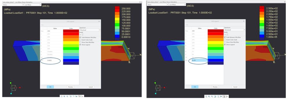

Using Creo Simulate 3.0 for static stress analysis.
When I generate results; for certain models; the stresses  are given as e.g. 150 MPa.
For other Models (using same analysis and modelling units): 1.50e+02 MPa
I would like to change the latter output example to match the former (i.e. 150MPa).
However I cannot seem to be able to find a setting?
In 'Format Legend Edit, the result is shown as MPa also, but cannot find a way to change the result 'table'  from +00 to (non engineering) units.
Please find attached, I want the legend results to appear in MPa (as per edit box), not 'e+02', as in the results window.
The same 'non consistent' output legend occurs for other results, such as displacements.
Any ideas?

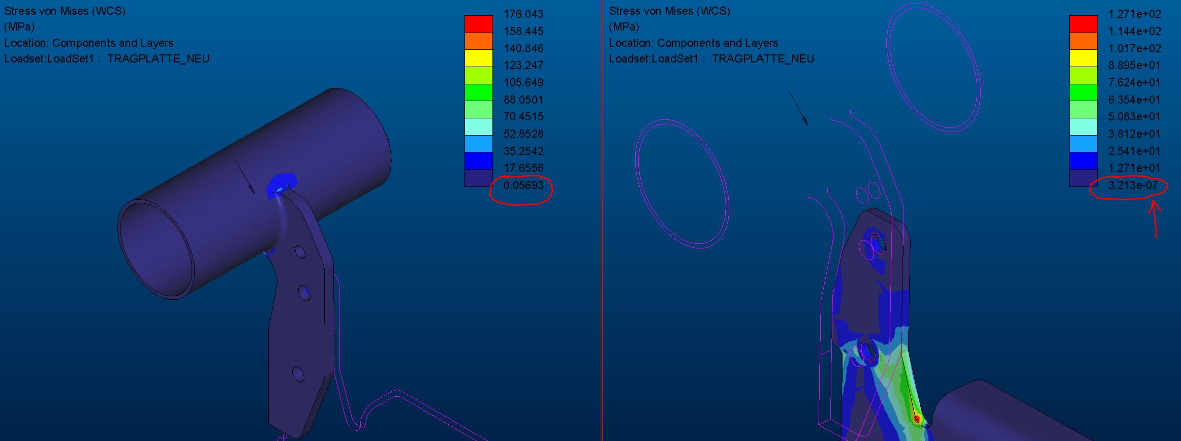

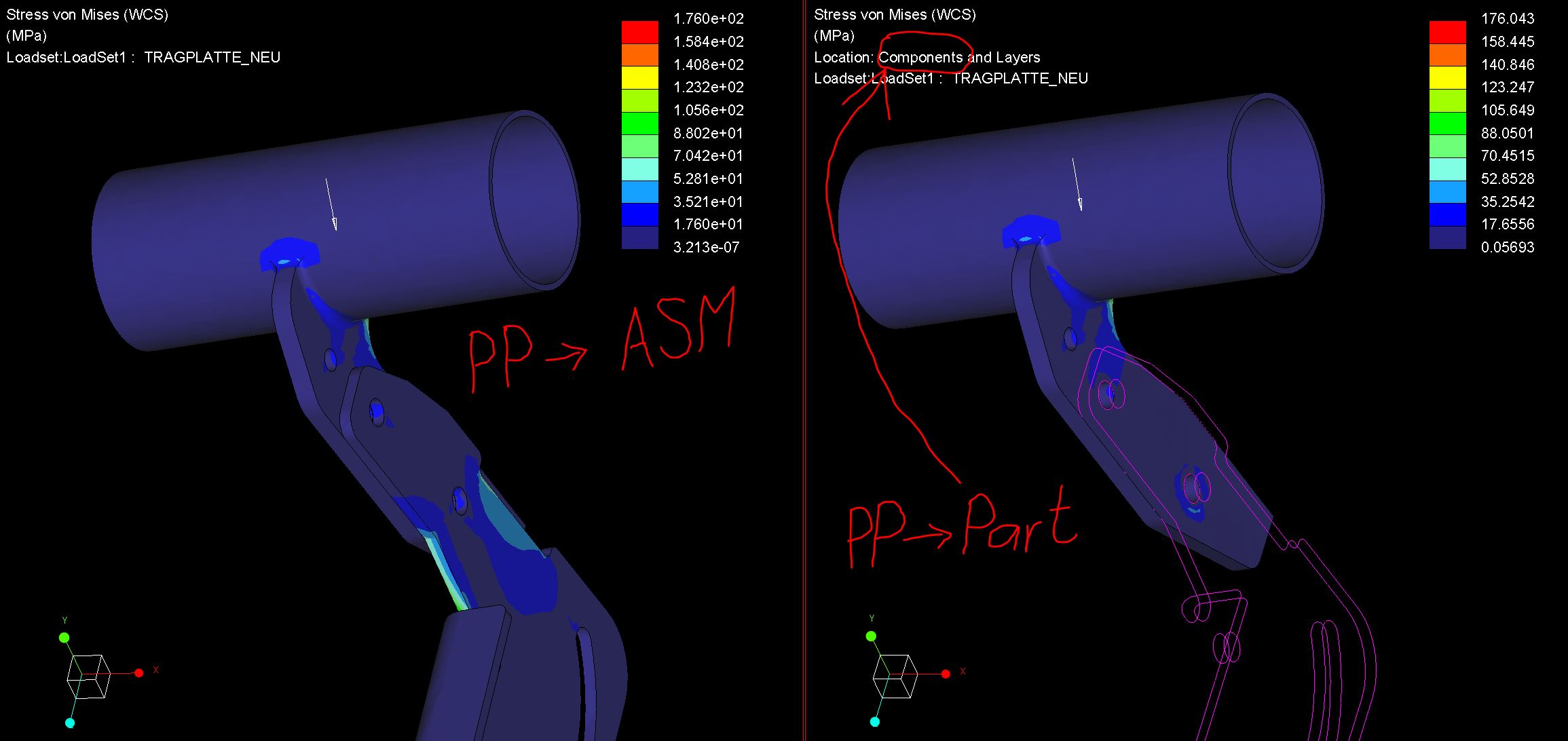

Hi all and thanks for the replies.
For certain models the screen output is '150MPa'  and consistent with the legend edit box.
A 'consistent' output for another model is here:
My issue is when I am trying to publish work which directly compare stresses between models.
e.g. One stress from a Model is given as 200 MPa and the other Model uses the 2.00E+02 MPa engineering format.
My issue is whether there is a way of changing the ENG (+00) Stress Output to a standard format.
Neither are incorrect, and this is basically semantics, but it is frustrating I cannot make the results screen units into MPa per se, not adopting the e+02 unit format for certain screen displays.
Regards

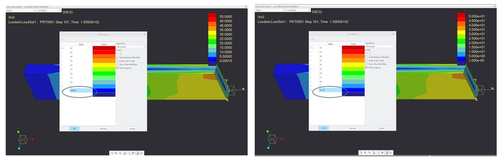

Another case shown here:
This is a Strain Output for same model which presents 'matched stress nomenclature' I showed before.
Again, the screen uses ENG, and the Legend presents as a decimal.
Another model, showing equivalent strain shows in a dp format.
Maybe not a great example as Strain is dimensionless, but a comparson between results can lead to confusion as dp needs to be converted to a strain -0X.
Also, sometimes I may like to present in microstrain (-06) but I cannot find a way to convert the results output.
rbowen1-VisitorAuthor
June 9, 2016
Same Model as showed stress in MPa (consistently) :  Max 152.657MPa
The Strain was inconsistent.
Still in the same results dialog box (still using VonMises failure); I change the 'display output' unit to kPa and I get this difference.
The screen now presents as ENG format (+05), and the Legend box gives in Pa.

Yes, I also believe it is controlled by the legend minimum.  These images demonstrate how to switch from floating point to scientific format (MPa and Ksi  examples)
