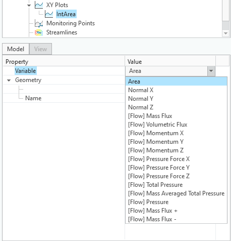

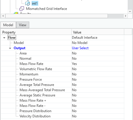

Thanks for this post ... I have the same question or the same request. It would be great if PTC would enable calculation of average and mass averaged report for velocity (so, similar as for total pressure). This option should be available either through XYPlot either/and through interface output property.
@tmoser : good advice until implementation of my proposal into Creo. 😀

Thanks for your suggestions. We will discuss this internally and expand the output list. In the meantime, you can use expression editor to compute a user defined output e.g. mess averaged pressure at any boundaries etc. It is very straightforward. All other suggestions are welcome, you can email to support@simerics.com or directly to me ls@simerics.com thanks.
