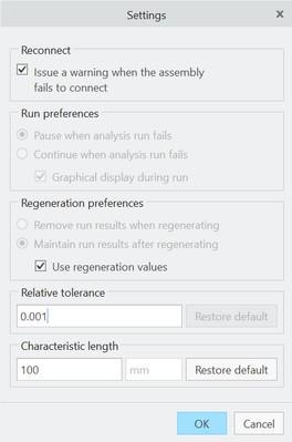

You are on the right track because it is a good idea to check models for their sensitivity to frame rates.  I also may check them relative to the mechanism relative assembly tolerance (1E-5 vs 1E-6)  This setting also affects simulation times, sometimes dramatically.
Creo mechanism is not generally an impact solver.  It may have trouble if the stiffness involved are too high and the time travel of force/displacements (speed of sound issues related to stiffnesses).  The cable stiffness must be reasonable, not rigid.
However, the first thing I would try is setting your assembly accuracy to something other than the default 0.001 relative tolerance.  1E-6 would be my first try.  Here is a screenshot of where to set that.
FILE - PREPARE - MODEL PROPERTIES - Under Assembly mechansim select change

Just thought I'd follow-up since I've learned more about this issue.  I agree with SweetPeasHub, you should at least decrease your mechanism tolerance by a couple orders of magnitude.  It certainly sounds like you have the default 1E-3.
