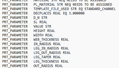

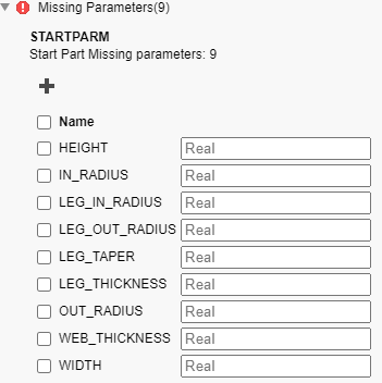

STARTPARM is enabled and the parameters from the start file exist in the part, but ModelCHECK still flags them as missing.

I believe you need to check the designate box to make the parameters readable by windchill.

What you need should work without STARTPARM at all.
It looks like you have MU_ENABLED set to N in config_init.mc.

March 10, 2026
Try using STR in your ModelCheck file instead of REAL as a test. We do not have anything set to REAL.
