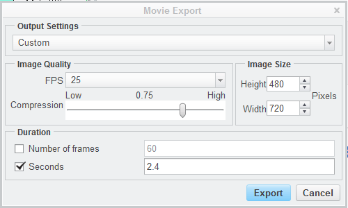

The highest video resolution you can currently output from Simulation is 720x480.  This seemed appropriate 10 years ago, however for a really professional presentation I would like to have options to output full High Definition 1920x1080, or 1920x1200, and other more standard choices 1024x768 etc
IF you agree please like this post.

We have keyshot, but I donโ€™t know how that would relate to me wanting to save out a video from Simulation of FEA results with the change of shape from deformation and color based on stress plots.

I prefer to use screenshot tools to capture animations. This built in function is not good: poor resolution, large file size.
August 28, 2015
I get around this by using CamStudio:
CamStudio - Free Screen Recording Software
August 30, 2015
Not sure where this limitation comes in but I've had it do much better.  one thing to consider is that for some reason, you cannot get exact values.  I've posted a support case about this and got back a "works to specifications" reply.  It use to be that the limit was the size of your monitor.  Not sure if this limitation still persists.
But your underlying conclusion is correct; very little has been done with this part of the code since decades ago.
One work-around I found useful is to save as BMP files and stick them together later into an animated GIF.  This gives me more control for short presentation bites.  I use PhotoScape to generate animated GIFs.
