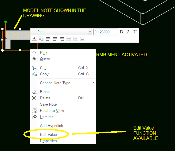

I am using Creo 3.0, M130; there seems to be something that happens which bugs me.
Usually, I show model notes in the drawing and then tweak them by using the "Edit Value" function from the RMB menu:
My questions is - often, this function just isn't there...  It just so happens that it's working for me now, so I don't have a screenshot available 🙂
So I don't know how that happens, but when it does, I have no choice but to go open the model and edit the note from there.  This is very frustrating.  Restarting Creo works to fix the issue, but that's not a good solution.
Does anyone else have the "Edit Value" function disappear on them?

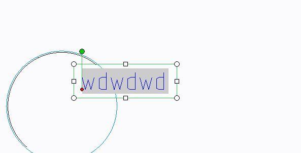

(To:psobejko)
I tried to reproduce the same situation, but my RMB Edit Value is always shown. You have to make sure that the text is outlined with the control boxes as shown in the image before Edit Value will show up.
