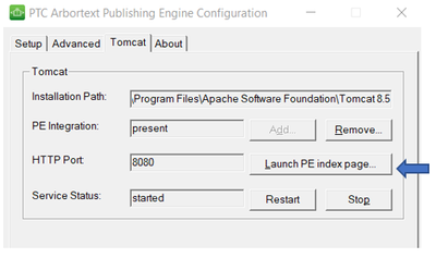

  1. Clicking on ‘Launch PE Index Page’ under Tomcat Tab, it does not launch the page or few of the information is not populating correctly/missing.M_Milutinovic_5-1682533218356.png
  2. One of the main reason is, DCOM configuration is missed, and it can be set by reading this Help Center topic Configuring Publishing Engine Post Installation
  3. Post that restarts Tomcat Services and retest the use case
