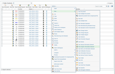

In the WC folder view, Under the Actions > New dropdown menu, we found New Graphic Information Element.

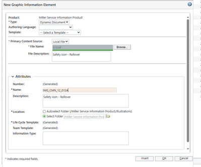

  Selecting New Graphic Information Element, followed by Type > Dynamic Document in the popup window.  This opens another popup window where the file can be searched for using Browse, or you can drag/drop the file from File Explorer, whichever is more convenient.
We entered a local description and name and selected the location by checking the bubble for Select Folder
Clicking OK saves the image to the graphics folder.

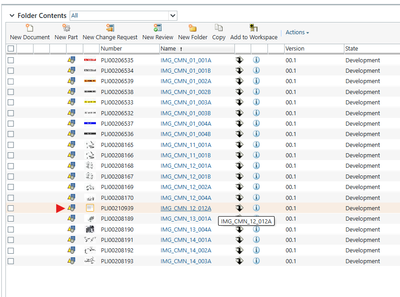

Once saved, a look in the graphics folder shows it is there as a dynamic document image saved as a PLIXXXXXXXX number.
When inserting the image into Arbortext, it shows up in the preview and the link is listed as image href="x-wc://file=PLIXXXXXXXX.jpg".
Publishing it works like a charm.
