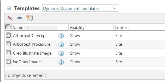

Can someone explain why a new option appears in the New Dialog when connected to Windchill? Can it be suppressed?
The Windchill instance is SIM 10.2 M030.

Hi Jeff-
Are you logged on as Site administrator? SIM creates two templates at the site level. Make sure you select "Dynamic Document Templates" from the drop-drown to the right of the "Templates" label.

Hi Jeff-
In SIM, open the Browser pane and select the Product. You should see "Templates" listed on the left hand side. Once you open the Templates section, see if you have one called "Tech Pubs...." and what its visibility is set to.

Hi Pushpinder,
There are no templates with that name. Just to test, I turned the visibility off for all templates, but the extra option still shows in Arbortext.

Hi Jeff-
Hi Pushpinder,
That was it! I changed the visibility and they are no longer showing in Editor.
Out of curiosity, what is the purpose for these templates?
