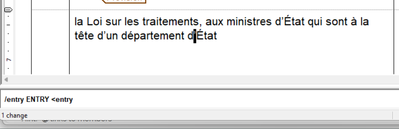

I am using Arbortext 8.3.  Here is the simple function in question:
replace("ʼ", "’", 0x2000);
The user has a file that contains a mix of apostrophes.  We want a consistent character used.  The first apostrophe is the U+02BC : MODIFIER LETTER APOSTROPHE {apostrophe} and the second (the desired one) is U+2019 : RIGHT SINGLE QUOTATION MARK {single comma quotation mark.
Using the following text, the last apostrophe is the one we want swapped.
la Loi sur les traitements, aux ministres d’État qui sont à la tête d’un département dʼÉtat

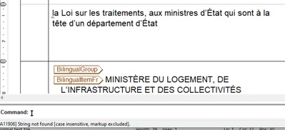

Using the replace function above, if I run from the command line in Arbortext Editor it works perfectly.
However, when I save that one line of code, as its own ApostropheSwap.acl file, and do a "source ApostropheSwap.acl", it does not find a match.
I have tried saving the .acl file as UTF-8 and ANSI, and both get the same result.
Any ideas would be greatly appreciated.
It is probably an issue with the special characters you're using. It may help if you use the chr() function instead of the literal character, something like this:
replace(chr(0x02bc), chr(0x2019), 0x2000)
I did a quick test from an ACL script file and this seems to work for me.

Thank you.    The chr() function did the trick.
