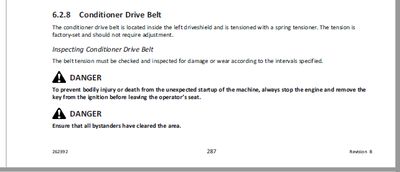

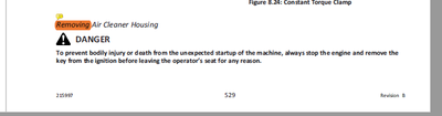

We have an issue where we are often left with a level 2 or 3 title and short description stuck on the bottom of a page, while the rest of the topic is on the next page.
What are my options? My thought is to create a rule that would check the room left on the page, and if the title element was within the last 3 in. of the bottom of the page it would start the topic on a new page. Is that possible?
