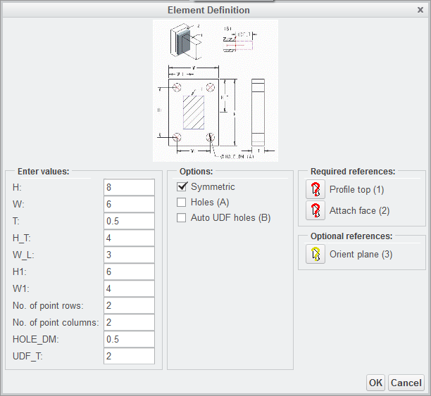

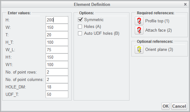

hello everybody i have a problem with advanced framework extintion (AFX) that is some dialog boxes are bigger than my laptop screen (i have 15.4 screen).
so i cant sellect all the options . is there any one knows how to solve this problem ? thanks
Best answer by Mahesh_Sharma
As all members mentioned this is due to screen resolution and in that dialog box, size of dialog box is increasing due to image/picture in that. If I have that machine and need to complete my project, I will prefer to remove that image from dialog box and have only input area (and I will keep a copy of picture which can be referred externally).
Image files are available in installation location of efx, in case of your uploaded picture file.
Browse to <Creo Install location>\Common files<Datecode>\efx\ parts\connectors\steel_construction_inch (or mm)\no_standard and rename endplate_align_size_tab.gif to endplate_align_size_tab.gif_custom
endplate_tab.gif to endplate_tab.gif_custom. This will remove the image from dialog boxes.
OR
I will open the *.gif files externally and change the Width and Height pixels.
Dialog box without picture:
Dialog box with modified pixels:
OR
October 6, 2014
thanks , it really works ..many thanks
