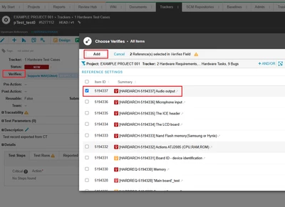

I would like to add a requirement item to the Verifies field, as shown in the attached example. To perform this “Add” action via the API, I used the items/{item_id} PUT API with the following body:
{ "subjects": [ { "id": {req_item_id}, "name": "Supports VOR(32 or 8kbit)", "type": "TrackerItemReference" } ] }
However, when I sent the /v3/items/{item_id} PUT request, I received an error: "State transition from New to -- is not defined for [HARDTC-{item_id}]".
Could you let me know if there is something I am doing incorrectly, or if I should be using a different API for this operation?
Thank you for your assistance.

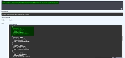

First I would suggest that  you use  GET /api/v3/items/{itemid}/fields to obtain the ID of the "Verifies" field.
Once you know the ID,  you can proceed with the second step, using  PUT /api/v3/items/{itemid}/fields endpoint to update the "Verifies" field with the necessary requirement item.
This is an example with step by step examples:
  1. Use GET /api/v3/items/{itemid}/fields, to find information about the referenced field

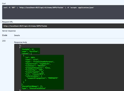

Here is an example where I already have an item added in the Verifies field:
 2. With the information about the reference field, you can go to the next endpoint PUT api/v3/items/{itemID}/fields and update the Verifies field
       Json body should look like this:
"fieldValues": [
"fieldId": 17,
"name": "Verifies",
"values": [
"id": 1074,
"name": "srs3",
"type": "TrackerItemReference",
"angularIcon": "lightbulb",
"iconColor": "#b31317",
"propagateSuspects": false,
"trackerKey": "SRS",
"trackerTypeId": 16,
"uri": "/issue/1074",
"referenceData": {
"suspectPropagation": "PROPAGATE"
"sharedFieldNames": [],
"type": "ChoiceFieldValue"
Let me know if this helped.
