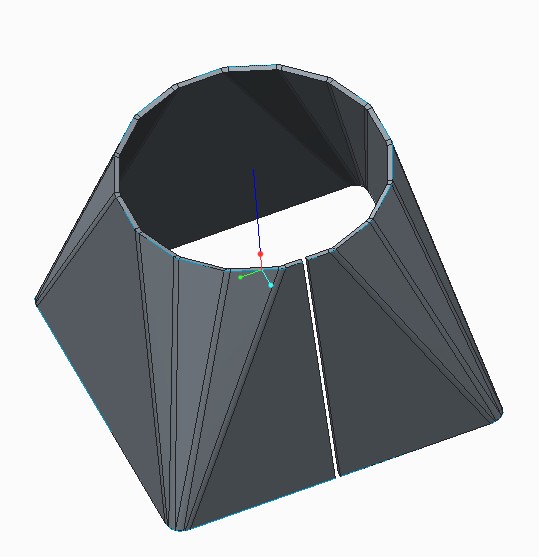

Hello, everyone!
I would like to get a flat pattern of a part, which was created using a Swept Blend in the Sheetmetal Module of Creo Parametric.

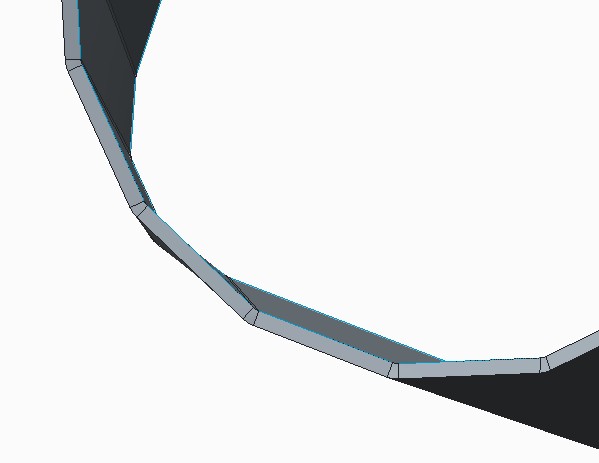

This Swept Blend consist of two sections. Each of them has the same quantity of segments. I used a Convert Tool to add bends on sharp edges to round sharp edges.
But when I was trying to create a flat pattern of this part, Creo displayed a warning message that there is no geometry to unbend.
Does anybody know how to solve this problem?
I attached a picture and a model of this part.
Thank you in advance.
Best regards, Vladimir.
Best answer by Vladimir_G
Hello, Davor, Antonius!
Thank you for your help.
Eventually I managed to get the flat pattern of my model.
The problem was that some of the sides of my part were twisted. That happend because the lines on the opposite sections, which I used to make the Boundary Blend, weren't parallel to each other.

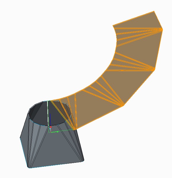

Actually, I've seen your model before. That's great. I repeated it step by step and flatten it.
That is the reason why I attempted to use the Boundary Blend tool for my part.
But I would like to exchange every conical bend for four angled bends in order to create a Table of Bends (as you can see in the picture above). I would like to show bend lines in a view with a flat pattern and point the value of the angle of each bend in the table of bends.
When I try to use your technique for my part it doesn't work. I can't flatten the model.
P.S.: There is an option in Lofted Bends tool in SolidWorks which is called Bend Line Control. It enables you to set the number of bend lines for conical bend.
That's what I'm looking for in Creo Parametric.
June 6, 2012
I guess you need to put it in "idea" area as a enhancment request.
Maybe you can make quilt from outer surface and flatten it then use Flatten Quilt Deformation tool on solid part. To me its too much work. PTC must make something simpler.
