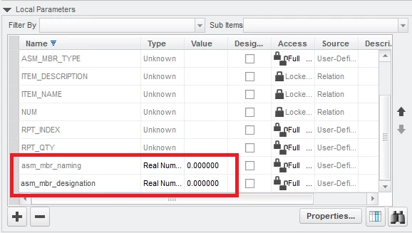

I am sending modified drawing. It contains following repeat reqion.
The most important change was made in Local Parameters section of Relations dialog box. I added two parameters - see red rectangle.
I clicked OK button and the Relations command again. Now new parameters were displayed as shown below.
So ... basic rule, which must be fulfiled is ... every parameter mentioned in relations must be present in Local Parameters section. Unfortunatelly parameters, which are not displayed in repeat region cells must be added manually.

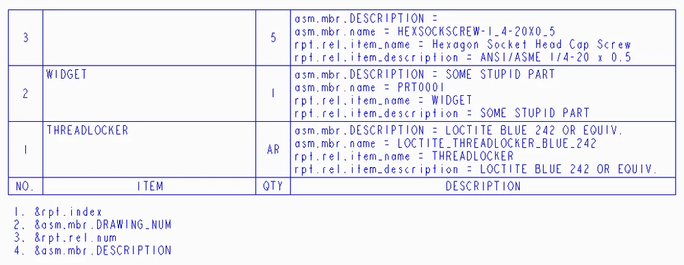

Here is my repeat region:
And the result:

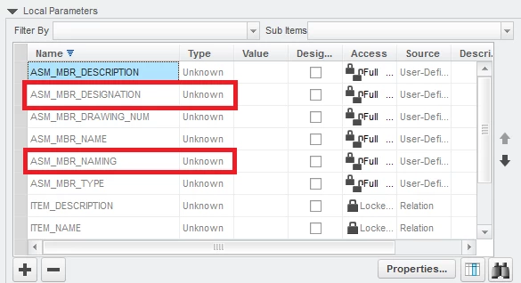

October 6, 2017
repeat region relations are not correct. You cannot use if exists("naming") !
You have to:
  1. add ASM_MBR_NAMING parameter in Local Parameters area in Relations dialog box
  2. use if exists("ASM_MBR_NAMING") command

use asm.mbr.Item_name and asm.mbr.item_description in your repeat region.
October 6, 2017
That is what I'm currently using. It works for the parts I've created, but not for the hardware.
