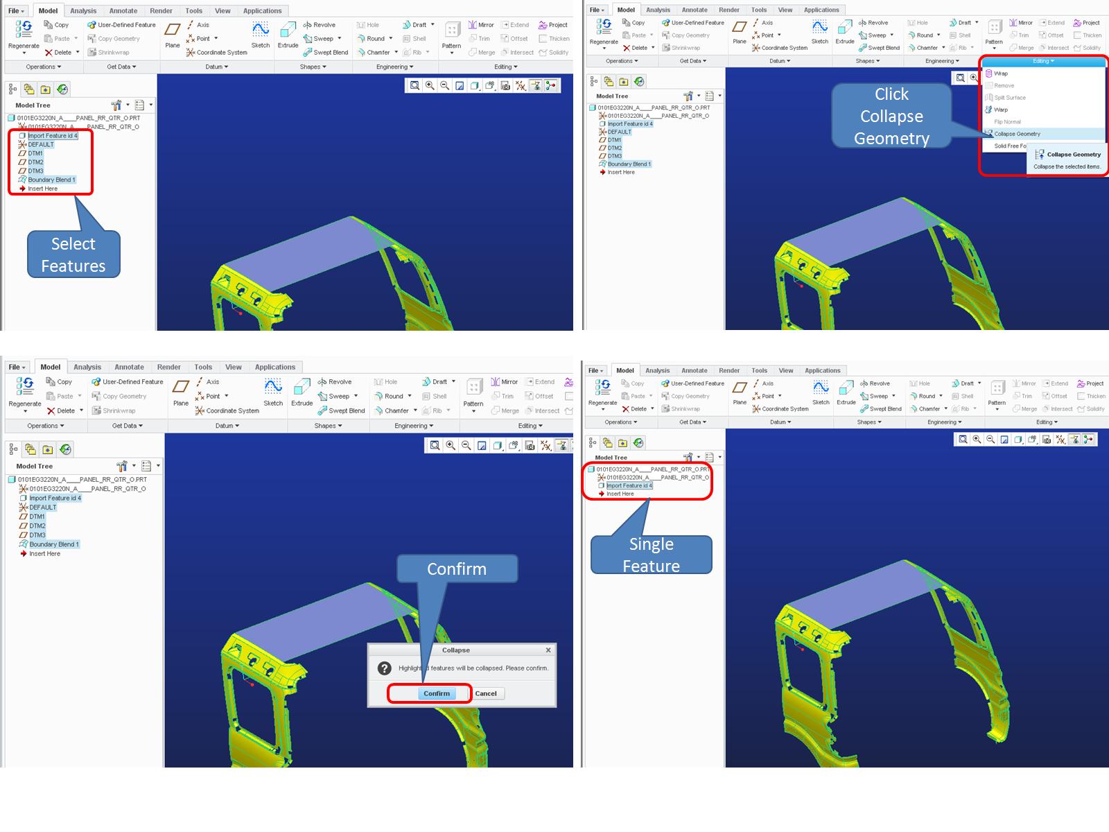

Hi
Try to use command search to find this option
This option is under editing tab
This option is is still available but not in Geometry tab
Regards
K.Mahanta
Hi
For those who have never used this option;
See the following example to know some of its its utilities
Regards
K.Mahanta
Hi Mahanta:
Thanks very much for your answer. I used this method to manage the "reference geometry", I have find this command and check you method. it is correct.
