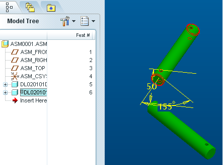

see pic
if i change connection from cylinder to pin it will show its name but not in cylinder connection why?? unable to find..... ![]()

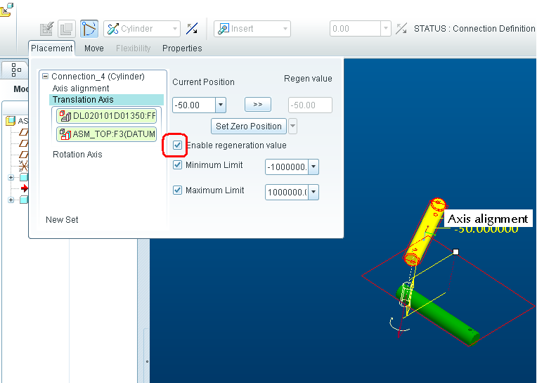

If you have enabled Enable regeneration value; then you should be able to see the value by edit option.

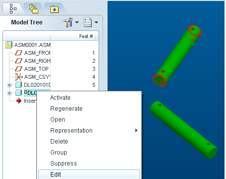

Right click on the second part (of the cylinder connection)and select edit as shown in the picture.

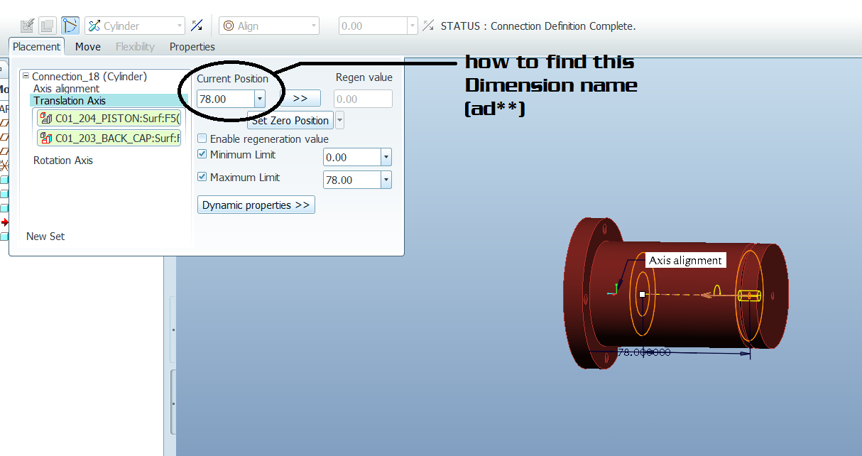

I know in Creo Pro E 5.0, you can right click on the feature, select edit, and then select and right click the dimension and choose properties - this will show you the name and also allow you to rename it.
thanx 4 ur rply but problem is it do not show dimension (in edit mode) which im pointing in pic..
