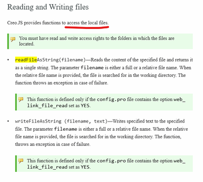

Hello, is there any possibility to read files from network drives?
try {
 print(readFileAsString("\\\\10.170.84.24\\Standard\\ProE_standard\\Relace\\Relace PRT.txt"));
} catch (e) {
 print("FAILED: " + e);
I need to read fresh relations so all models actual relations. The only one place in our company provides relations is network drive.

You followed this settings:
Not sure, but web based apps have no access to file folders, make sure to add the config path.

Do you have web_link_file_read config option set to yes?
https://www.ptc.com/en/support/article/CS156638
20-Turquoise
January 27, 2026
@ilyachaban wrote:
Yes, I do and it works if I read from 😧 or C: drives. But when i reach out to network drive it can't read a thing
It probably has to be a mapped drive.
February 6, 2026
  • creo_js_app.conf:
    • readable_folders = ${CWD}; C:\xxx\xxx;
    • writable_folders = ${CWD}; C:\xxx\xxx;
IT WORKED. Thank you so much.
