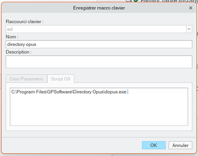

I wrote this in mapkey file
mapkey ed @MAPKEY_LABELOuvrir directory opus dans répertoire de travail;~ Command `ProCmdDwgTblSaveasText` ;\
mapkey(continued)\ @SYSTEM "C:\\Program Files\\GPSoftware\\Directory Opus\\dopus.exe";
It does open directory opus but not in the working directory.
I also get this message in the status bar in Creo :
14:18 Erreur de macro clavier : Invalid trail file line : No palette found for command 'ProCmdDwgTblSaveasText' in context 'context_main_dlg_w1'.RaphMORIN_0-1770902333408.png
