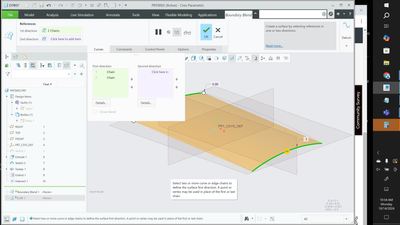

I'm not sure what you are explaining. Can you provide a screen shot?
This is a boundary blend... in the past the dialog box would remain closed forcing the user to open the box to add other direction for example.  I had to pan the model out of the way to make my selection.

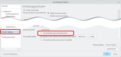

I think this is the setting you want. Not sure if there is a config.pro option for it or not.

That is stored in a .ui file along with all of the windows settings. It is not set using a config option.
Managing UI Customization (ptc.com)

thanks yall.  Ill try that now.   WORKS.  Now if it's a config setting Ill know what to search for now.  Thanks again.
