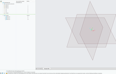

Yes, I did, but now I am getting the Message (translated from German):
The modelscene contains a roomenvironment, that is no longer supported. For this reason, Creo has updated the scene to a supported environment. The model must be save again, to avoid this message in the future.
I have saved the empty model and opened it again as template. It's not working. I am still getting the Message about the Environment.
Their solution did half-work on my issue. Now I am getting a different notification (translated from German):

your picture is too small, error message is not readable. Next time upload picture of message area, only.
Suggestion: Check settings of model scene. Maybe https://www.youtube.com/watch?v=XDlAjRpFlgE will help. Scenes are accessed on 0:22 time.

I already checked the Scene and I couldnt find anything. Are you sure it has to do something with the model scene?
