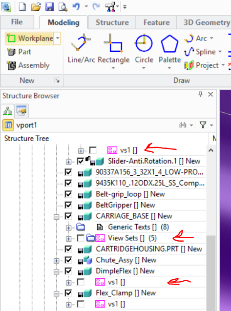

I recently received a .pkg file with a full model and I found that it also had drawings in the structure tree. My question is how do I see these drawings so that I can export to PDF?
I have tried to open them from Annotation tab but it won't let me select from the structure tree or save from there to PDF. Is there a way to view these? I don't want to redo work that someone has already done.

A Drawing and corresponding model (part, assembly) can be saved together in a so-called bundle file (Extension .BDL)
The "Sender" Needs to create this Bundle and send it to you.
However, only *one* drawing at a time can exist in Annotation, so a Bundle file can also only contain
one (of possibly many existing) drawing.
Access to all drawings is only possible when you have access to the Model Manager Database,
so you can decide which of (many) drawings you want to load.

The purple icons that you're calling drawings are view sets.  The view set is object that relates a model to a drawing.  It is not a drawing.  You need to receive drawings (MI) file that made by Annotation from your partner.
