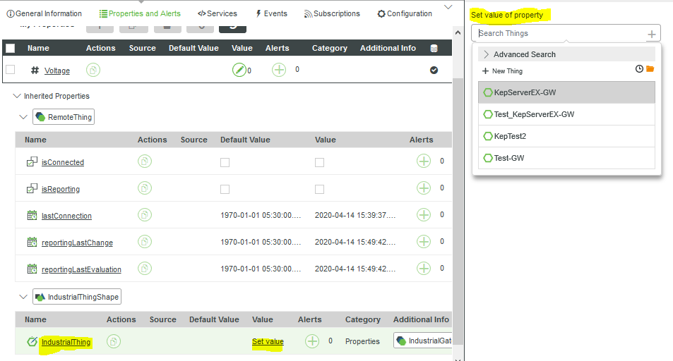

I have Thingworx and Kepware installed on the same server, but Remote thing is always disconnected when trying to bing a kepware tag in thingworx via the industrial gaeway

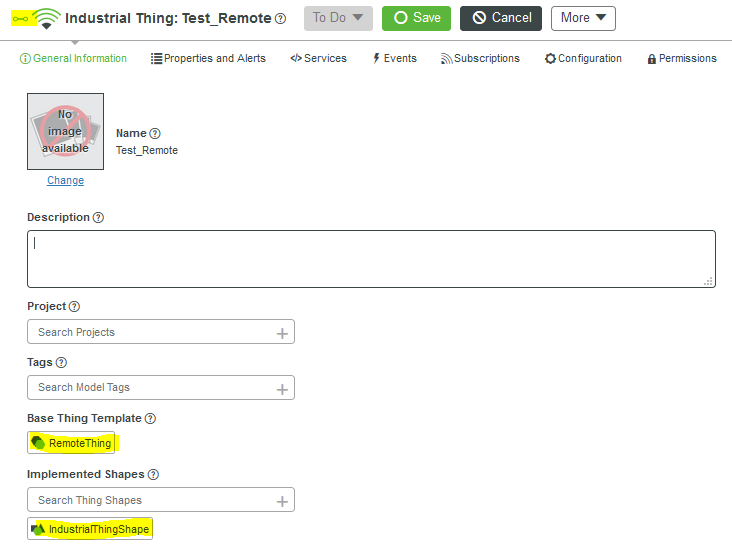

Hi @vigneshmurthy
Sure you can install KEPServerEX and ThingWorx on single server. On Your Remote Things add a  ThingShape  'IndustrialThingShape' and on Properties and Alerts tab  set value for property  IndustrialThing and select  the Thing used to connect between ThingWork and KEPServerEX.
Abhishek

Hi @vigneshmurthy.
To expand on Abhishek's response, while it is possible to run both Kepware and ThingWorx on the same machine, this is not a recommended configuration for a production environment.  Over time you may begin to experience performance issues, especially if you are also running the ThingWorx persistence provider on the same machine.
Regards.
