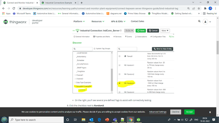

For info, I am using the following guide :

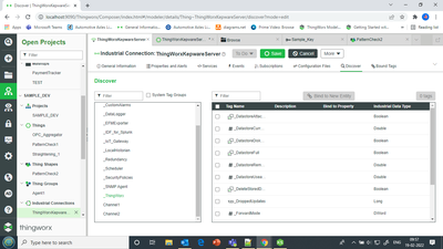

To connect the industrial binding, in the guide it showing simulation example, but in my composer it is not displaying. TWX and Kepware is both in my local server.

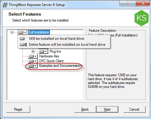

It doesn't need an additional license. I don't have applied for any license and just select "Entire feature will be installed on local hard drive" when installation, then the "simulation example" can be seen under the Kepware project list.
By the way, the "Examples and Documentation" is also showing 0kb on the same installation page. Do you follow all the installation steps/options list on Thingworx help center? Can you see "Simulation Examples" channel in your KepServerEX?

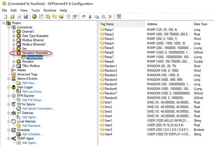

"simulation example" should come from KepServerEX, as shown in the below image:
Thank you for the reply. Can you please tell me this simulation example ,you have created a tags manually.
It's created automatically if we choose to install "Examples and Documentation" feature when installing Kepware:

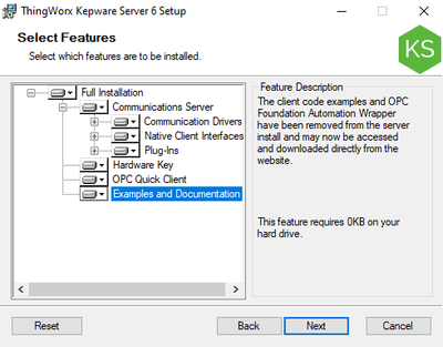

I re-installed kepware but I still did not get the simulation examples and also all the other features below aliases were also not seen.
Then I tried installing again and noticed that the simulation examples is showing 0kb. Does it require some additional license?
