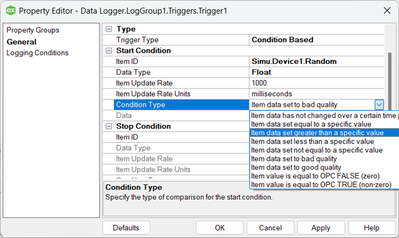

How do I setup a trigger so that the Datalogger only log data when the trigger bit goes High, or low, but not both?  I'm getting double data because it triggers on change not rising or falling.
Greetings,
You can set the triggered conditions as triggered-based and then set the condition type according to the data type. If the item ID has the data type Boolean, you can set it as OPC False or OPC True, but if you do have any other data type, you can set the condition as greater than or less than a specific value

Talk about timing.  I had figured that one out just about 2 hours before I saw your response.  I do appreciate that you took the time to help me out though.  The fact that we both came up with the same idea gives me confidence that it must be a useful solution.
It is working in actual use so that's even more proof.
