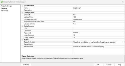

Is there a way to enable and disable the log group with a trigger from a PLC? I need to have the data logger create a new table each time the log group is triggered.

Yes, we can configure Datalogger to create a new table every time new log is started.
Please check the image attached and Manual.

We need the data logger to create a table each time the log group is triggered not enabled? The log group does create the the new table each time it is manually enabled but not each time the logging is triggered from the PLC to start. The log group has to be enabled before we can trigger the logging on and off via a PLC tag. When we enable the the log group, that is when it creates the new table, but it appends the log data to the same table each time we trigger the logging to start. We need separate tables for each triggered data log event from the PLC.

I believe there is some confusion, I am specifically referring to the Kepserverex Data logger. I have read the entire manual and I can get the Kepserverex data logger to log data to my table in the data base using a trigger from the PLC; all of that works. Since we are turning on and off the data logging with the trigger each time a part is processed in our tool, which the PLC is controlling, the table is filling with appended data for thousands of parts and millions of rows of data that needs to be parsed. It would make more sense to automatically create a new table for each processed part, but to do that you would have to manually disable and then enable the log group to create the new table each time a new part is processed. There has to be a way to create the new table automatically or the Kepserverex data logger plugin is useless as a data logger.
