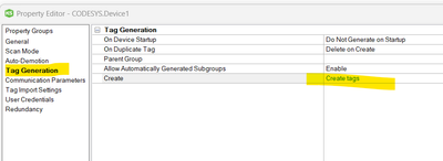

I just connected Codesys to Kepserver via first running a virtual PLC via codesys control win and running my program. Then I created a Codesys channel using all the general settings. When adding a device i changed the type of communications in use to CODESYS V3 Ethernet, the address when connecting to the device (Address Type: Logical Address/PLC Name and also the Logical Address to my Device Address from Codesys.
But after running Kepserver it tells me my Device is not responding. I have looked at the other thread and since I am new to Kepserver and Codesys I don't really understand what is going on. The addresses for my tags should be right. Any help would be greatly appreciated. I have added lots of screenshots just in case. If you need any more let me know.

The address looks good, but to avoid any syntax issues, I suggest using the Auto Tag Generation feature of the driver.
