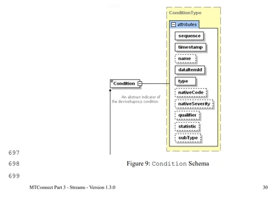

We are currently relying on some attributes commonly implemented in condition-type dataitems within MTConnect, namely "nativeCode" and "nativeSeverity", but it doesn't seem like these attributes are being picked up by MTConnect driver on triggered conditions?
