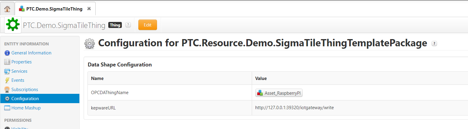

Hi Team,
I do have a question about the Chapter 6, Extending your TW Manu APPS.
I have followed the instruction and it doesn't work as expected.
When I triggered an Alert in Sigma Tile PI, it cannot be automatically displayed in LED, leaving errors in KEPServerEX.
Date           Time            Level           Source                                     Event
7/25/2017      12:02:13 PM     Warning         IoT Gateway                                Write rejected for item '.Screen_Control': the tag has not been added to the plugin.
7/25/2017      12:02:23 PM     Warning         IoT Gateway                                Write rejected for item '.Screen_Control': the tag has not been added to the plugin.
7/25/2017      12:02:33 PM     Warning         IoT Gateway                                Write rejected for item '.Screen_Control': the tag has not been added to the plugin.

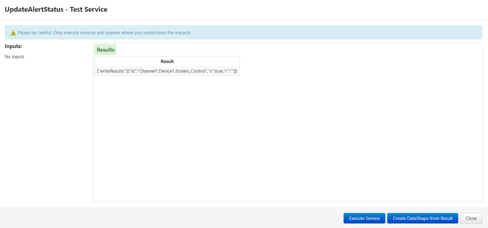

If I execute the Service manually, the alert is displayed in LED.
I do believe there is some problem in the Services but I have no clue to dig, like the Tag Name you defined in the Service.
Could you help with that?
I have changed the OPCDAThingName to my Asset name, as well as the URL in IoT Gateway.

IoT Gateway is well configured and running normally, but write failed, seems like the tag '.Screen_Control' doesn't exist.

I can only trigger the alert, however, it will not displayed in Sense Hat display.

Then Check .Screen_Control tag exists in extension. If so check the device names (fully qualified name) as well.
On the IoT gateway, you do not have to use REST call. Instead, you can configure the tags such that it can write back using Native TWX-Kepware integration.
