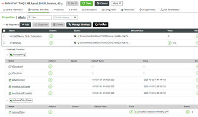

Thing is disconnected (Gateway is set and connected)
Ninja_HH
7-Bedrock
Thingworx: 9.3
KepWare 6.18
Some Industrail Things can not connect to KepWare.
The Industrial Gateway is set. All other Things are receiving data and everything is fine. Only 5 assets won't connect again.
I resolved this issue. For all others who have the same problem, this resolved it:
Article - CS446285 - Industrial Thing doesn't connect automatically or Remote Things get disconnected after Kepware restart when using CXServer
Resolution
  • Include the following parameter on the JVM executing the CX Server:
    • Where XXXX must be bigger than the number of Remote Things bound to the Industrial Thing
-Dcx-server.protocol.websockets.client-binding-limit=XXXX
