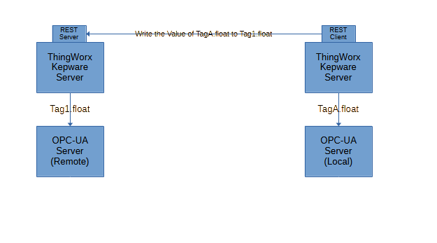

I have a use case where I must take some OPC-UA tags and send them to a REST server which is then connected to another OPC-UA server using ThingWorx Kepware Server on both sides. Here is what my configuration looks like:
- ThingWorx Kepware Server on Remote PC configured as a REST server. This REST server is bound to one FLOAT type tag on a test OPC-UA server. I can read it and write to it just fine using powershell and my web-browser.
- ThingWorx Kepware Server on Local PC configured as a REST client. The REST client points to the REST server configured earlier and reads one FLOAT type tag from the source OPC-UA server (production data). The idea is to publish this OPC tag to the REST server earlier (which should then automatically update a tag on the test OPC-UA server it is bound to).

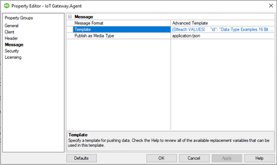

I tried to do this using the Standard Template in the REST client's message body but I keep getting ERROR 500. I can use the Advanced Template like this and it works but the value is obviously static,
[{id: Tag on My REST Server,v: 22}]
I want the value to be written dynamically (fed from the source or prod OPC-UA server). When I do something like this, I get ERROR 400.
[{id: Tag on My REST Server,v: |TAGVALUE|}]

A visualization of what I am trying to achieve.

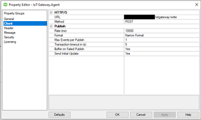

- Next, make sure your REST client uses the following URL: https://<ip address>:<port>/iotgateway/write
- Set Max Events per Publish to 1.
- Use the advanced template and ensure that the message body looks like this. You can leave the header empty.
|#each VALUES|
    "id": "|TAGNAME|",
    "v": |VALUE|
|/each|
