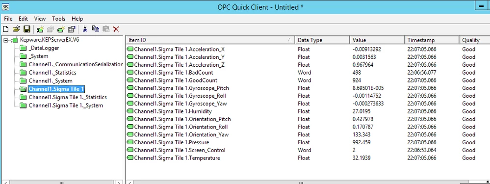

According to the latest sigma tile documentation, if I open an opc client for kepware using the SenseHat_v5 opf, I should see entries for ErrorCode and VibrationAlert.
For the opf file linked to from the LearnKepServerEXUsingSigmaTileGuide, these two tags do not appear.
Any advice?

I saw in another thread the advice to manually add the missing tags.
I was able to follow the advice  and then the joystick on the SenseHat could toggle through the error codes as the documentation describes.

Missing ErrorCode & VibrationAlert tags as well
I've looked around for a solution but cannot find.   If you have it, could please post?  Thanks
ccertain
6-Contributor
(To:wpollock)
Here you go with the kepware export file. See attachment below
