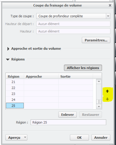

I'm discovering the new volume milling with Creo 3. I have a volume milling which contains 24 regions. I would like to reorder them like in Creo 2, I mean by picking directly in the window. It looks like, we're supposed to use the two arrows you can see in the image below but it's really not efficient ! Any idea to do this the old way ? Thanks

if you want to select the region directly in the graphics window, in the dialog box, click the button "Afficher les régions" then right click in the background and select "Région de volume de fraisage"reoder_volume.jpg
and pick region

Thank you for the answer but this is not exactly my problem. In fact, I'm able to select regions (when they display, because sometimes for no reason, you click on "display regions" and they don't display !!). Once you've selected a region it shows it on the list but you still have to reorder it with the arrows up and down.
I would like to reorder them by picking the regions in the order I want them to be milled like in all previsous version of Creo and Pro/E.
