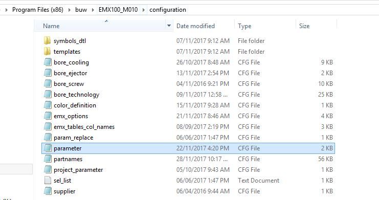

Abhinand
(To:scooke)
Hai,
Please check the below CFG file available in your installation folder.We just installed EMX10 in one of our windows 10 system and found that parameter.cfg file is missing in the installation folder. may be copy and paste will help.thanks
