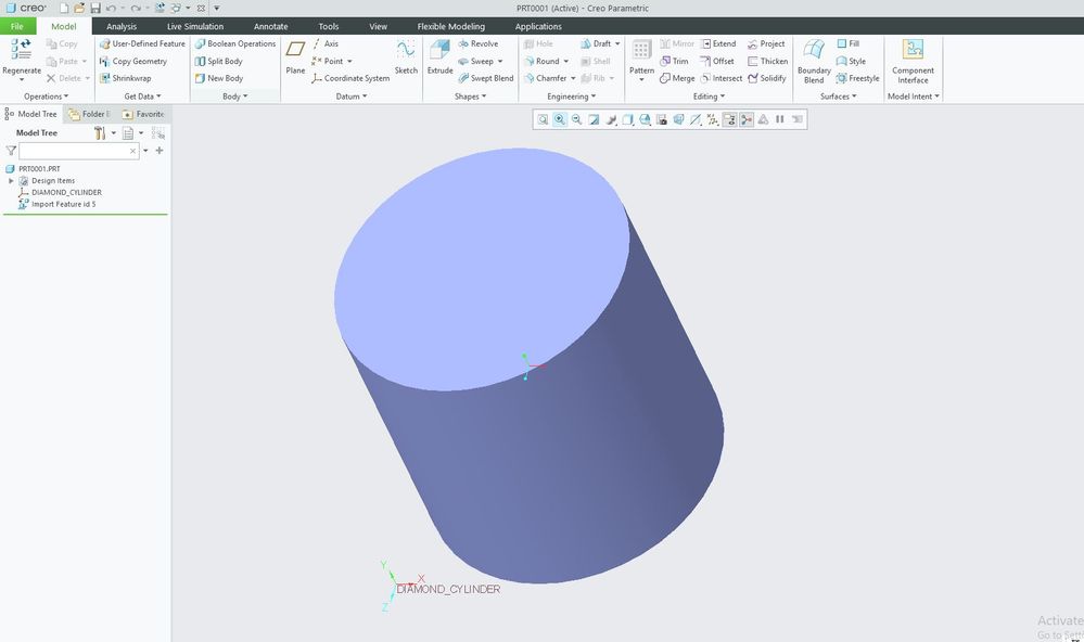

Hello, everybody,
Does anyone meet the problem when saving the part file to step, the lattice design is missing?
For example, in the first picture, I created a lattice structure, I then saved it as step file.
But when I open the step file, it appeared as the second picture.

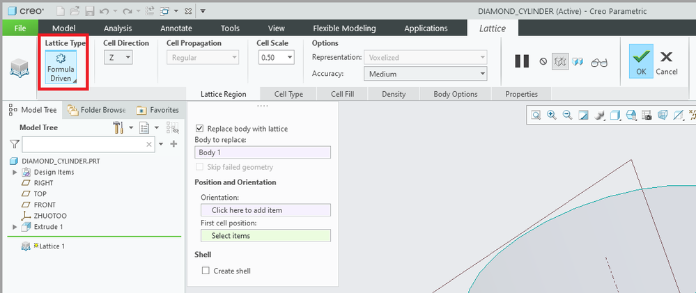

Formula driven lattice cannot be exported to STEP.
Please read https://www.ptc.com/en/support/article/cs303867 document.

please specify what type of lattice did you create and what Creo version did you use (Creo 8.0.?.0)

Hello Martin,
Yes, Creo 8.0.
The lattice is diamond.
I have uploaded the model.

Ok, got it. It is sad.
However, it can be exported to stl., not so convinient as to step file though.
Thanks for your information.
