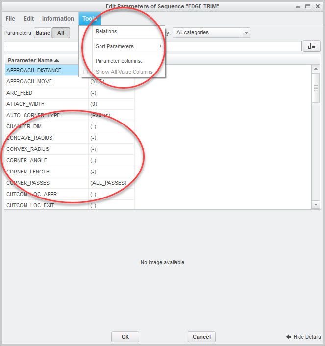

Edit Parameters Tools menu is missing options and the parameter list is abridged. There are tons of missing parameters in this particular manufacturing model. CL_DIST is a big one that my Post Processor uses and it has gone missing in the parameter list. Starting a new manufacturing file remedies the situation but I need to know how to fix the one that is already complete as there is a lot of work already done and starting over every time this happens is not a solution. I need to know how to correct this issue if it ever happens again. I did attempt to export the parameter list from a good model and open in the broken one but I receive a long list of errors stating not valid.

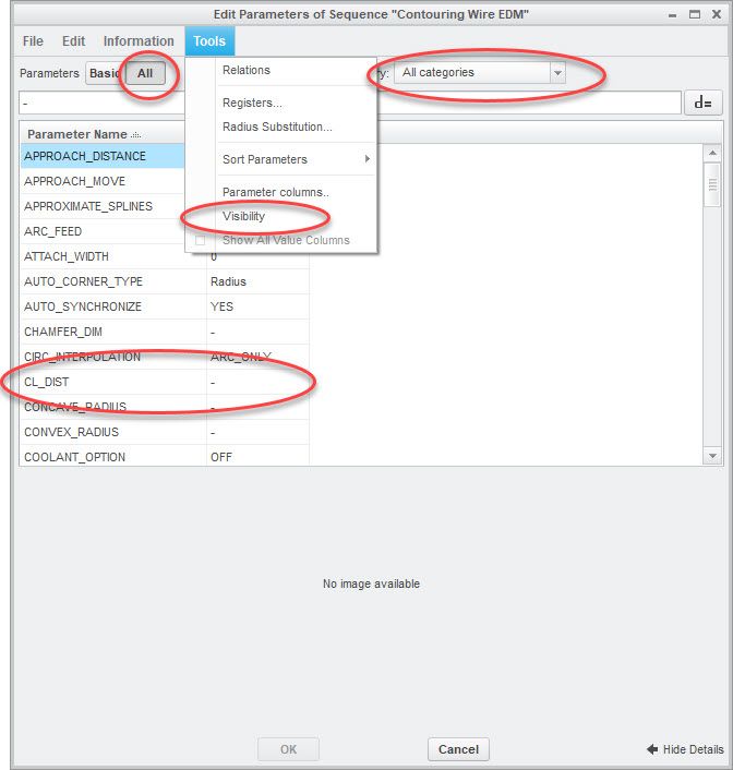

Thank you for your response Ken. The parameters I am speaking of are not the standard parameters in the regular tools menu. This is within the manufacturing module. They are entirely different and the parameters that are missing are within the cutting operation. As I mentioned, I attempted to export/import from a different model that isn't broken but that is when Creo complains and throws the errors. There are menu options completely missing from within the tools dropdown as well. It is a very odd situation.This is from a good model
This is from the broken model. Visibility missing from tools menu and tons of parameters missing from the list.

Nope, same version of Creo. Same working directory. It is a very odd behavior most definitely. I am doing Wire EDM but pretty much same procedure for getting an NC file out of Creo. I really appreciate you chiming in Ken.

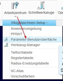

Maybe you have to check that box here.
I have no wire, so it is not showing, but the option is still here for me to show you:
Thanks for the input. Unfortunately we have found that an old Config file was causing the issue. We started with a fresh Config and it works again. Who knows but its just one of those Creo things I guess.
